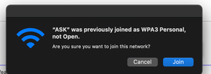

RBK 852 Satellite Security Type: None
I have found that my wifi satellite is not secure on the satellite only on 5 ghz. I have tried to reset but when I do it creates a new wifi SID for my 2.4 on my satellite. You can see my mac connecti...

So if I reset my primary device as well as my satellite back to stock I tried to just reset my satellite 10-15 times without any luck so I reverted the primary device to make the Orbi work again. Do the base setup and then switch to AP mode as long as I keep my satellite as wireless for backhaul and my primary device plugged into my network on my internet port all seems to be happy. I can make any change I want to the WIFI and it is replicated between the primary device and the satellite.
So my setup before in which I recreated the problem. I believe this is being called out as "wrong" but has worked for over a year. I have a Unifi Dream machine that is my router. Then I wired my AP both primary and satellite into the lan side of the network ports. This seemed to work for almost a year without issues. Both my Orbi devices worked as simple AP devices and seemed to work well as a mesh wireless network.
My goal tonight is to plug my satellite into my primary device directly and see if my network configuration continues to replicate without issues. My assumption at the moment is plugging my primary and satellite devices into the "network side" of the orbi devices causes issues?
