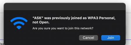

RBK 852 Satellite Security Type: None
I have found that my wifi satellite is not secure on the satellite only on 5 ghz. I have tried to reset but when I do it creates a new wifi SID for my 2.4 on my satellite. You can see my mac connecti...
