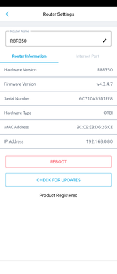

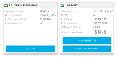

But this may be a clue: see previous response. The RBR350 picks up the DHCP response associated with the MAC address for the LAN side. I see no DHCP broadcast request from the WAN side MAC address, otherwise I would see this from the pool range leases from my DHCP server, and regardless it would still dish out the desired gateway.
Before jumping to conclusions, let me double check what I think are the MAC addresses from WAN and LAN side of the RBR350.
Snip from desktop web browser 192,168,0.80
This suggests it is the LAN side that picks up the DHCP broadcast response.

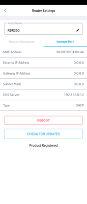

Screenshots from smartphone via Orbi WiFi
Note that the internet (WAN) side External IP Address is 0.0.0.0
This confirms the response from CrimpOn indicating no access from WAN side in AP mode.
But I need "Internet Access" for Firmware Update, NTP, Speedtest.Help!
