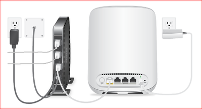

This is operating in an environment with 40+ devices and several NETGEAR and other switches. Servers (desktops, laptops, etc.) are wired using CAT6A or CAT5E. Mobile phones are connected via 5G and IoT devices via 2.4G with the ISP cable modem WiFi (Virgin Media Hub 5) on a different SSID from Orbi. DHCP and DNS are served from my own servers (with failover provision for when a server is unavailable).
Servers with attached 10-bay HDDs (acting as NAS) are noisy, so have been relegated to the garage, but the CAT6A cable between garage and cable modem is ugly and hard to disguise.
The purpose of the Orbi plus Satellite(s) is purely to replace this CAT6A cable. Line of site distance about 5m through 1 single skin brick wall. In other words: 1 ethernet cable into the Internet port of the RBR350 and one ethernet cable into an ethernet port of the satellite RBS350, WiFi is unused apart from the fronthaul and backhaul. Administrative access to the RBR350 is via the wired ethernet from a desktop web browser.
Although I think I can accept the additional latency of a wireless fronthaul/backhall, the bandwidth is critical. There are regular "rsnapshot" backups during the day, transferring many GB of data, typically taking half-an-hour or so over the present 1Gbps wired configuration. Half the bandwidth would mean this time extends to over an hour with knock on consequences.

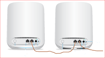

But can I double the bandwidth by using two satellites in parallel? I propose having the RBR350 (router) connected to my ISP modem, but not so close that the WiFi of the ISP modem does not interfere with the Orbi WiFi.
I then propose placing the two satellites close together, but 5m away from the RBR350, with wired connections between them:
My assumptions (hopes) are:
- Although there is only one router RBR350 box, it has sufficient capability to talk to each of the two satellites simultaneously.
- The firmware supports packet distribution to each satellite and subsequent ordered reassembly at the destination.
Is there anything to gain from this arrangement, or am I just deluding myself?
