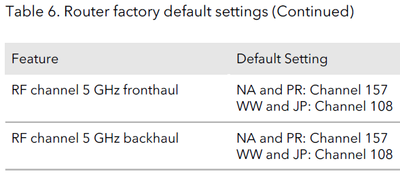

    The 350 series is an "odd duck" in terms of being Dual Band WiFi rather than Tri Band.  With only one 5G radio, the 350 is designed to use the 5G channel that the Tri Band Orbi's use for router-satellite communication (backhaul) as a combination user facing and router backhaul link.  Notice on page 128 of the User Manual that the default 5G WiFi channel is the same for both user and backhaul (varies by country)
