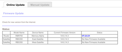

I purchased the Netgear RBK653 kit (Router + two satellites) a year and a half ago. Two months ago, Netgear released a firmware update for the router — but not the satellites:
I’ve learned (the hard way!) that one should never update the router unless (1) you’ve updated the satellites first, and (2) the target firmware versions (satellite and router) are a match.
Since the v7.3.x.y firmware update, according to the release notes, “addresses security vulnerabilities,” that means that anyone with an RBK653 kit has been operating for almost two months with an under-patched router — and is therefore vulnerable — because Netgear has not provided a patch for a fairly recent device (which I think is irresponsible of them).
Other than buying additional Netgear hardware (which I would not want to do right now), is there any alternative — or way to goose Netgear into actually supporting their recent products?
And recommendations would be welcome.

      Hi, schumaku, thank you for trying to help.
      The links you provided are for the firmware versions currently installed — and were released in December 2022 (a long time ago).  The current firmware for the RBR750 is 7.2.6.31 (released on April 10), which would be what I would like to use if Netgear had provided that update for the RBS350’s that came with my RBR750. Without the corresponding 7.2.6.31 for the satellites, the 7.2.6.31 update for the router should not be used. That is precisely what you posted — and precisely the problem I am asking about.
      I wish it was that easy, but clearly it is not.

    Just disable Auto update on your RBR. V7 FW is not compatible with RBS350 series units. Not sure if NG will be updating them or not. If the system works with v4 version loaded on all units, you'll need to keep v4 version on all units. You can't update the RBR to v7 or the RBS350s will no longer work.
    Maybe later at some point if NG doesn't do anything for the 350s, find you some used 750 RBS on places like Amazon, Ebay or Shopgoodwill. Get one or two 750s then update them to v7 FW first the the RBR lastly.
    If your having problems with your system, please post the details and we can help you trouble shoot them.
