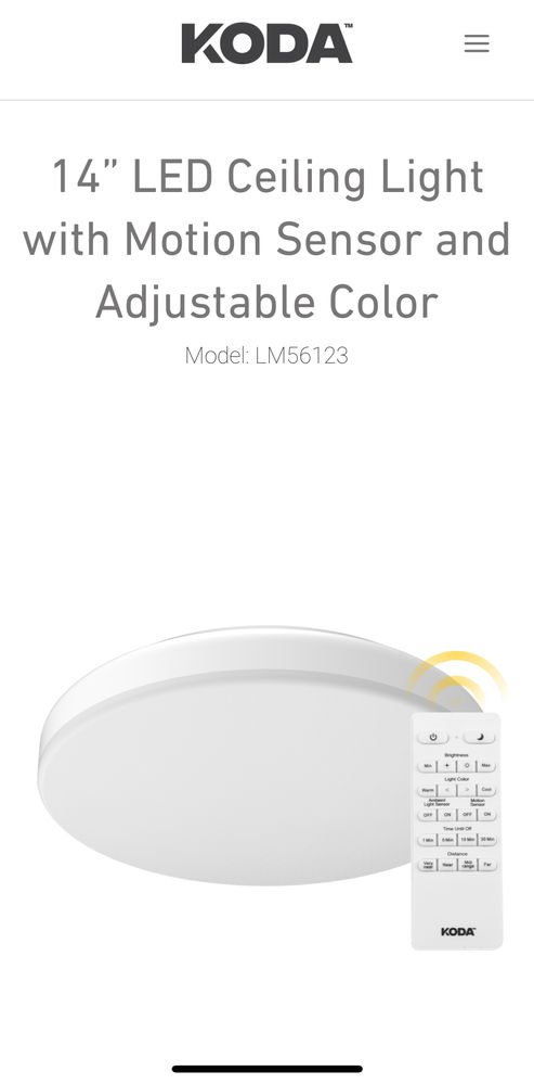

Update:
So I kept troubleshooting around the house to understand what was causing my backhaul to drop. I narrow it down to the thing that we use the most at night, since it was at night time that most of my issues occurred. Turns out that it was a ceiling led lamp that I bough of costco who was causing the interference. The lamp is located in the same room as the router and every time I switch the light on my satellites turned magenta. I hope this helps.

Wow, thats interesting. Didn't think a LED lamp would cause this problem. What is the mfr and model of this lamp?

Here is an article about LED lamps causing RF interference.... It is a thing for some brands

FURRYe38 wrote:Wow, thats interesting. Didn't think a LED lamp would cause this problem. What is the mfr and model of this lamp?
Interesting fact. I have the same lamp in the room where the satellite is and I have no issues on that end. Maybe I got a defective lamp or it got damaged through time. I’ll report back once I replace it.- Mikey94025Jun 23, 2020Hero

Interesting fact. I have the same lamp in the room where the satellite is and I have no issues on that end. Maybe I got a defective lamp or it got damaged through time. I’ll report back once I replace it.The interference may be very sensitive to the relative position of your router/satellite relative to your LED light: https://www.pbs.org/newshour/science/war-on-christmas-lights-wifi-interference#:~:text=Visible%20light%20from%20your%20holiday,of%20radio%20and%20WiFi%20frequencies. . Try moving the Orib around, within the room, and see if it makes a difference.

Let us know of that works or moving the RBS around as well. Seems to be issues with these LED lamps causing problems of there own.

Interesting fact. I have the same lamp in the room where the satellite is and I have no issues on that end. Maybe I got a defective lamp or it got damaged through time. I’ll report back once I replace it.- CreezJul 12, 2020Tutor
So after moving the router around the room like crazy and having no succes finding a sweet spot where the lamp dosen't interfere, I went online to search for possible isolation materials for Radio Frecuencies. Found out that alumium was one of them. So I when to the kitchen got a roll of aluminum foil and cover the lamp power supply and the proximity sensor with two sheets of foil. I made a really small hole to expose the controller reciver eye. Turned the light on and problem solved. No more dropping backhaul connection. I know its not the most ideal solution but it gets the job done until I find a new lamp that I like. Hope this helps.
