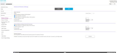

I'm unable to connect my previously functioning 2.4ghz devices to the new Orbi mesh network. Let's focus on the Wyze cams for now. I have the v2 and v3. I've tried a few things: Cutting the 5ghz...

1) prior system was split SSID. So no it's not possible in this case as I'm trying to mesh on the original main 5ghz SSID.
2) in USA and the max channel option I get is 11.
- CrimpOnDec 21, 2020Guru - Experienced User
2) in USA and the max channel option I get is 11.Thanks. Since the previous SSID is no longer available, I would do a "Factory Reset" on the Wyse cameras and set them up using the Wyse app with the new Orbi SSID. It worked for my two Wyse cameras.
