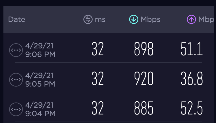

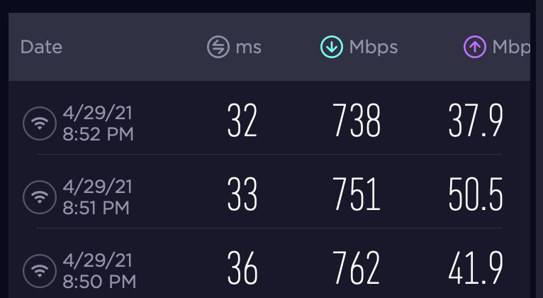

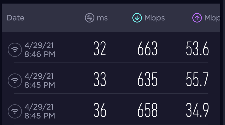

Ran a few tests myself on my 8 series with v1 loaded: Armor/TM disabled. DST Enabled. CTS set to 64(default)
Mac Book wireless connected to RBR: 866Mbs Connection Rate
Mac Book Pro Connected near the RBR: 1300Mpbs Connection rate which is max rate for Mac Book Pro 2018
Mac Book Pro wire connected to a NG R7800 router in wireless bridge mode connected at 1733Mbps to RBR:
