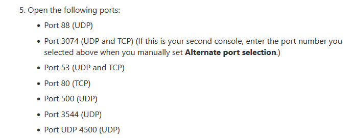

A very common remote play issue is having a Double NAT, which blocks connections from the internet to the XBox. That Spectrum modem does not create a Double NAT, as evidenced by the public IP address assigned by Spectrum to the router. Nor did the XBox report a Double NAT.
Which method for guaranteeing access to the XBox did you choose? For example, did you assign a fixed IP address to the XBox and then forward these ports to it?
