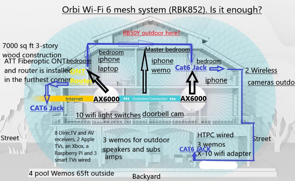

RBK852 devices connected through ethernet ports are slow.
It is encouraging that some people are using this new system without any major bugs. Thank you FURRYe38 all other for your contribution. My laptop or desktop connected through ethernet ports of bo...

DoctorA wrote:My laptop or desktop connected through ethernet ports of both Router and the Satellite are slow. Instead of 950 Mbps before, I only get 200Mbps wired. Wirelessly I am very happy. On iphone Xs max I get 650 Mbps in different rooms where the router and satellite are connected together with wire.
If the wireless clients connected to the router or to the satellite are making this speed, it looks like the poor wired LAN performance on both the router and the sat on must be a bug. As with other users having deployed Orni AX with a wired backhaul suffering from poor throughout, it appears the Beta was mainly wireless backhaul oriented.
DoctorA wrote:The Router's WAN port is connected ATT 's Arris BGW 210 RGW in pass through mode. ... If I can't fix this problem, was thinking connecting all the wired devices to RGW and all the wireless devices to this mesh system.
With the Orbi Router in router/NAT mode, there would be two different networks. With the ATT device in pass-through mode you will only get one (or a very low number of (public) IP addresses assigned. The approach would be using the expensive Orbi AX in wireless AP mode, and enable the routing/NAT on the ATT device again.
DoctorA wrote:I need to add 1 RB50Y outdoor wired to my exsisting RBS852 satellite for my outdoor devices 65 feet away from the house.
The RBS50Y can't be (Ethernet) wired - it is a pure wireless satellite - I'm afraid.
PS: Great documentation showing cabling and layout - saves a lot of questions!

Thank you very much for your help. I disconnected the wire between the Orbi router and the satellite and everything wireless is working fine. Also the laptop pysically connected to the Router with a short ethernet wire performed at 950 Mbps after eliminating RBR to RBS wire connecting LAN signals from ONT/ RGW room to the master bedroom. I tested that wire again and it is capable of Gigabit speeds and there is no managed nor dumb switch involved. All this points to possible bug in the wired backhaul like you mentioned. This, plus your suggestion to use this indeed "expensive'' system as only AP and your new information that the RBS50Y is only wireles made me to decide to get another system. I need a mesh system with 1 Router and 3 satellites in AP mode. I have 4 CAT6 jacks in my home. Perhaps AC3000 (RBK53) and one RBS 50. it will cost less with more coverage.
I hope there are no bugs in this 1 year old system. Any suggestions?
I have 4 AirTies 4920 mesh extenders with my Att RGW Aris BGW 210 and they can't handle all my family's devices.
Thank you

@DoctorA wrote:
The "central" room is in the left corner of the 3rd floor. There are only 2 direct CAT6 wires there for the whole house.
One wire goes to the left of the 2nd floor where it connects to NETGEAR Unmanaged Switch (GS305) for my 5 AV equipments.
The second wire goes from the central room to Master bedroom where there is another NETGEAR Unmanaged Switch (GS105NA) where the RBS 850 is now. If RBS 850 was working properly I was hoping to get rid of the switch. From that switch there are wires in star formation to the 3rd floor balcony , 3rd floor computer room and then 1st floor theater room.
$700 satellite, wired can't function like a $30 dumb switch. Patiently waiting for the next firmware update because I like the 650 Mbs speed and coverage of this 2 nodes system. I don't have RBK 50 system to compair but the wireless signal is amazing. From 650 Mbps on the 3rd floor near RBR or RBS speed drops to 350- 400 Mbps second floor going trough tile floors and multiple walls. On the first floor 200 Mbps under 3rd floor satellite and dropping to 10 to 20s but no dead zone in the most difficult zones with concrete walls on 1 side. In the backyard there is no dead zones even at 100 feet away from the building and 150Mbps at 50 feet.
Can RBK 50 do this?
