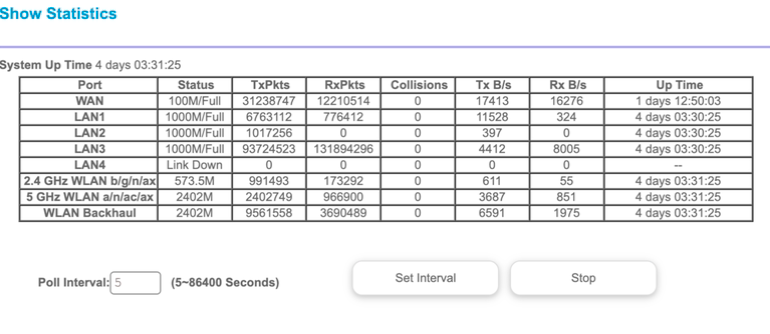

The next time this happens, would it be convenient to record what appears on the
- Orbi web interface
- Advanced Tab
- WAN port in the "Show Statistics" box
Number just slightly under 100Mbps are highly suspicious. Often this indicates that the router and ISP device hardware has negotiated a speed of 100Mbps. See:
https://en.wikipedia.org/wiki/Autonegotiation
100Mbps requires only two pairs of wire inside the Ethernet cable and 1000Mbps requires all four pairs. Not only do they have to be connected, they have to be connected correctly. For example, if the RJ45 plug is slightly loose in the RJ45 jack, it might be OK one minute and not OK another. Sometimes changing the cable fixes this.
Of course, if the speed drops to just slightly under 100Mbps and the Orbi continues to report that the speed is 1000Mbps/Full, then I have wasted your time.

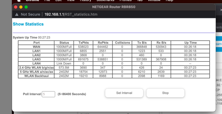

Is it the case that for some period of time, the Show Statistics page displayed a connection status of 1000M/Full for the WAN port and then it changed to 100M/Full?
- AKLGUYMar 15, 2023Apprentice
That just happens after random times. A full reboot. And it is back to normal.
