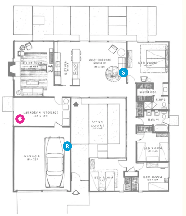

- House is about 2000 sq ft. Big open atrium with windows in the center. The distance between the R and S is about 30ft.
- IoT has about 12 non-wifi hue lights (connected to a bridge wired into the switch). No outlet switches. 5 sonos speakers. A bunch of 5 google home speakers, a few nest hubs.
In the diagram below I show the two Orbi devices and where the Mac is. (but I tested in various areas with the same performance)
One thing I wonder is if other people have the same looking Google Meet graph and they don't have problems. (even if I see different graph results on Google Wi-Fi vs Orbi)
