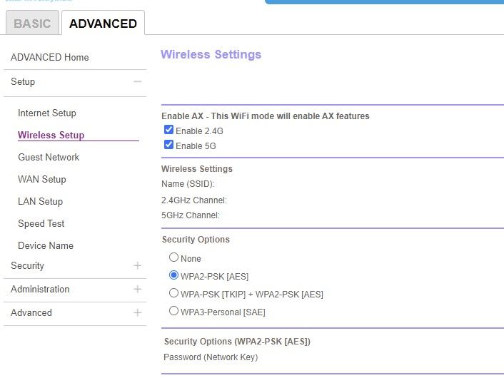

Hello I cannot connect any of my devices that are 2.4GHZ. I tried the troubleshooting to uncheck the 5G box. Not working I just keep getting reputed to change my password. I have two networks now ATT ...

Have you tried turning off AX mode?

How do I do that?
- FURRYe38Jun 20, 2021Guru - Experienced User
Remove the check mark and select Apply.
- Shaggylady_40Jun 20, 2021AspirantI want both 2.4 and 5. If I uncheck 2.4 will that allow the 2.4 devices ti be added to the network?
- LadySapphyJun 20, 2021Guide
It might, that is what this will test. AX is new tech to make wireless faster. the problem may be that your devices on 2.4 cannot handle the extra stuff that AX does.
Log into the interface via the web, go to advanced then go to setup then go to wireless setup. In there you will see AX mode on and off.
