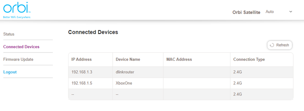

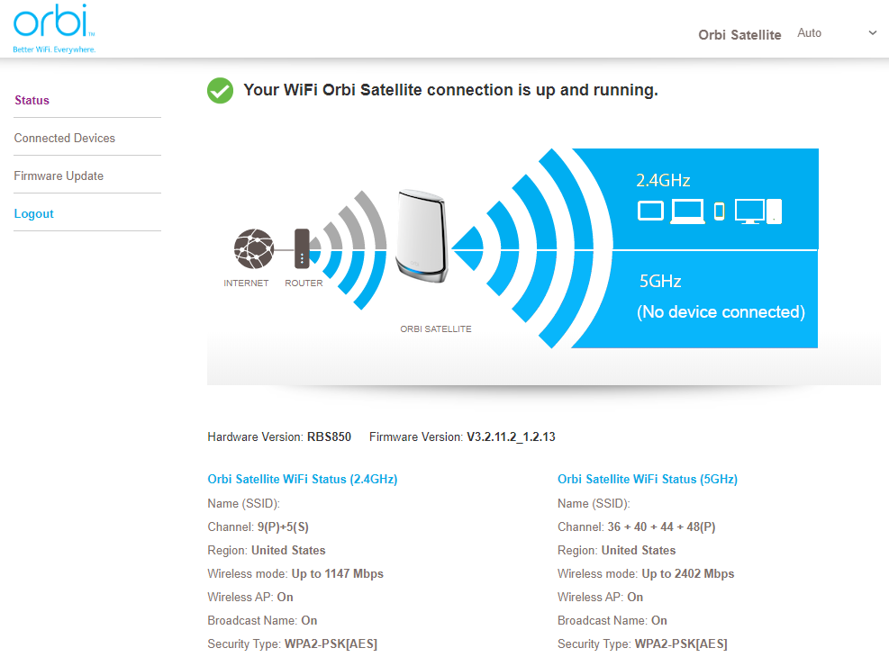

- FURRYe38May 11, 2020Guru - Experienced User
I did more testing on this and it is not reporting the 2.4Ghz status icon correctly if this what NG is intending for this status with 2.4Ghz devices connected.
I have my RBR on a 2nd story, and 1 RBR in the basement which is about 30-40 feet as the crow flies. I even turned down the RBRs 5Ghz radio to 25% and left 2.4Ghz radio at 100% to make sure the 2.4Ghz radios were connecting over vs the 5Ghz radio. Connected 1 D-Link DIR-868L in wireless bridge mode to the 2.4Ghz radio on the RBS in basement and wire connected a xbox to the back of the 868L via LAN cable. The Xbox connected and logged in with out any problems.As you can see the RBS status page is reporting there is devices connected to the RBS on 2.4Ghz side of the RBS. However the connection between the RBS and the RBR (router) reports as grayed out on 2.4Ghz. I presume this should be in BLUE.
I presume if the backhaul connection which all traffic is being sent back the the RBR, even if the devices are 2.4Ghz connected to the RBS, is the RBS taking the 2.4Ghz traffic and routing thru the backhaul as I believe this is happening since the xbox one connected to the 868L wireless bridge is getting xbox services and is logged in with out any connection problems.
It just seems like this is a RBS to Router icon status problem reported on the RBS status page is all.
