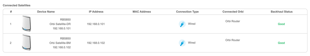

See attached screen cap from the GUI. It shows both satellites even though one is unplugged and turned off. :) Is that normal?

Update: I made the changes last night for the DHCP reservations IPs for the RBS to .101 and .102 rebooted everything. So far, everything seems to be stable. Continuous pings to the RBR, RBS and to www.yahoo.com have been consistent and stable, with no drops for the last 6+ hours so far as of this writing. DNS resolutions (using 1.1.1.1 and 8.8.4.4) are working fine so far. Keeping my fingers crossed! :)
