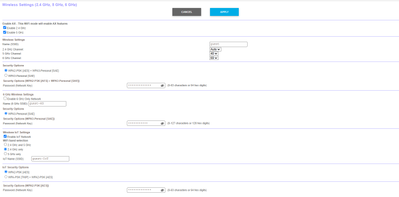

those are the channel configs:
| Europa | |
| 2.4 GHz Kanaal | Automatisch (8) |
| 2.4 GHz Draadloze modus: | Up to 1147 Mbps |
| 5 GHz Kanaal | 36 + 40(P) + 44 + 48 |
| 5 GHz Draadloze modus: | Up to 2402 Mbps |
| 6 GHz Kanaal | 65 + 69(P) + 73 + 77 + 81 + 85 + 89 + 93 |
| 6 GHz Draadloze modus: | Maximaal 4804 Mbps |
I use all dynamic.

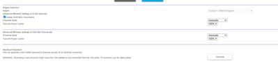

For that size of home, having too many RBS deployed could cause problems. Something to try, Turn down the power on the RBR from 100% to 50% and see. Under Advanced Tab/Advanced Settings/Wireless Settings

WHat u mean with rbs? I dont see it or u mean this settings? and it should work till 600m2 I mean thats big... ALso the standard things ive reseted and restarted already many times.
