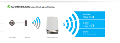

Hey, I got the rbke963 white edition 1 router 2 satelites acting in ap mode. My modem of provider shares the network with router of orbi. The point is network is dropping sometimes and I touch I...

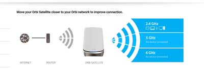

woops accidently accepted as solution but today resycned the satelites with the router the are wireless connected each other.
one satelite is good
other needd closer but it is not that far away from the other satelite. Does it take the connection from other satelite or not??? it is really nearly 6 meters away upside with walls.

Placement and distances will be key here. You may need to move the RBS around so they both connect to the RBR and not each other in daisy chain formation...
- Routerpr0blemJan 26, 2025AspirantHi so i need place those rbk en rbs more far away of each other? And the satelites are not wired connected.
- FURRYe38Jan 27, 2025Guru - Experienced User
Give it a try. Might place out sat 10 feet then check. I'd turn OFF the other RBS while you test this. Once it's connected to the RBR, test, then if all is good for the status, turn ON the other RBS.
