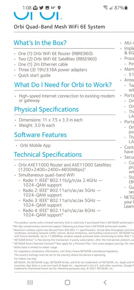

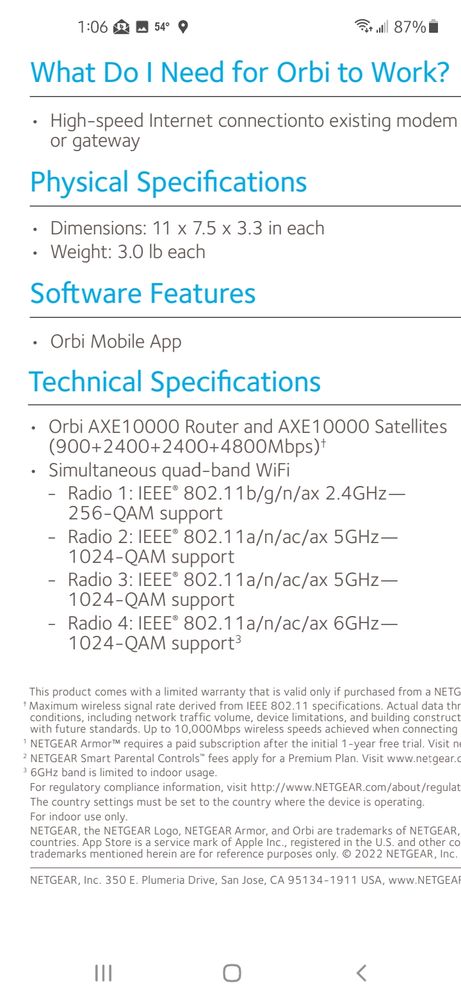

According to the data sheet for the RBKE953S vs RBKE963 - the 2.4Ghz band is showing a slightly lower MAX speed.
The 953 is 900Mbps max while the 963 has a 1200Mbps max.
Screenshots of the particulars from each of the screenshots are attached

This looks to be about the same the 950 series looks like its 2.4ghz radio is 256-qam and not 1024-qam of the 960 series. that makes the 950 a 900mbps 2.4, 2400mbps 5ghz, 2400mbps 5ghz, and a 4800mbps 6ghz=10500mpbs. The 960 series has 1200mbps 2.4ghz, 2400mbps 5ghz, 2400mbps 5ghz, 4800mbps 6ghz=10800mbps.

I currently have RBK753S and even that has Radio 1 with 1024-QAM for 2,4 GHz. I am not so much concerned about the total speed, but going back from 1024-QAM support to 256-QAM seems losing capabilities. My major concern would be how many devices you could connect. With most smart home devices running at 2.4 GHZ could that be a concern? Some places suggest 256 QAM can support up to 50 connected devices and if that is true, that would be a concern.
