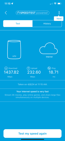

RBKE963 LAN Ports seem to be bottle necked at the Router
My Current Setup: Comcast XB8 Gateway (1.5 Gig Service) RBRE960 Router (AXE11000) connected to gateway via Cat6 patch cable with Cat6 connectors Firmware: v6.3.7.10 RBSE960 Satellites (3) tw...

- The FW issue is very interesting to me, because when I search for updates via the app, it tells me its up to date:
However, I can clearly see that there is another FW update available via the link you sent me. I will look to see if I can manually update the FW and report back. Thank you for that information and links!
