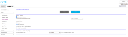

[RBR 750] Make guests use Chromecast on the main network (disabling Orbi guest network isolation?)
I have a RBR 750 in Router mode, and I'd like devices connected to the guest network to use chromecast which is on my main network. Ideally, I would expose the Chromecast device (and only that) t...

I see. It looks like devices within the guest network are also isolated from each other, right?
For example, I tried momentarilty putting the chromecast on the guest network. While it is visible from the devices on the guest network, casting doesn't work.
Oct 16, 2022Guru - Experienced User
I would believe so.
Guest Network is tied to the WAN port so any and all devices connected to the system get services directly from the WAN side. Nothing should be accessible to the LAN side from the Guest Network.
