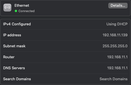

My Orbi system is RBR 750 and 3 x RBS 750. RBR was using as router. 3 x RBS connected with RBR using wire. I was using fine when loading firmware 4.6.11.1 Few day ago. I tried to update firmware ...
Few day ago. I tried to update firmware to 7.2.6.31. And from that day, my system had problems. I tried to downgarde the firmware back to 4.6.11.1 but the problems still there.
I cannot connect to my system. But all devices still can use wifi.
