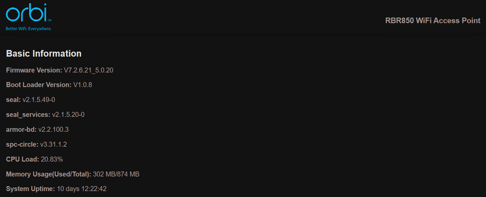

With the new firmware the RBR does not show the manually assigned IP (AP mode) in the dashboard:

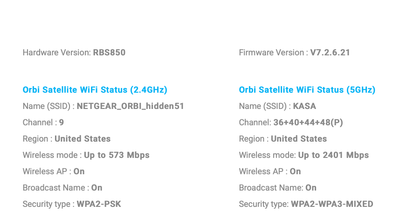

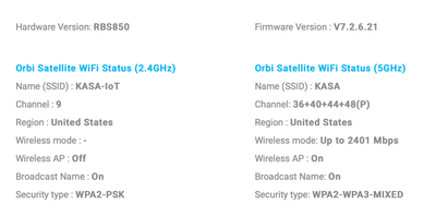

During the various RBS reboots and syncs the RBS interface would cycle the 2.4 GHz SSID:
In the above states (both persisting for 15/20 minutes each and "resolved" by turning RBS off and trying to sync again) clients accessing the 5GHz network were unable to get an IP and connect to the SSID (KASA)

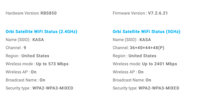

current RBS admin interface

This is mine IN AP mode:
