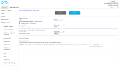

      These settings are not available for the ORBI RBR350 it seems.

        What happens if you un-check the box next to 20/40Mhz and apply the setting and reboot the RBR and have a wireless device connected to the RBR. I would disable the devices wifi radio for 5 seconds then enable it while near the RBR to ensure it connects at the RBR.
