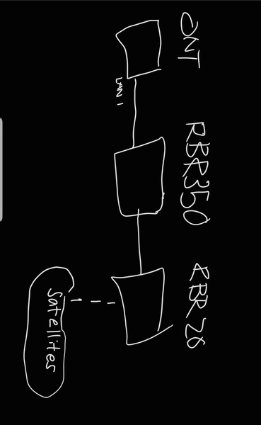

Got you here is a photo. The RBR350 is basically connected to the ONT box via the red marked ethernet wire. Right now the RBR350 is inside this metal panel box so that it can connect to my PC. Note that in the provided photo the black marked ethernet wire is basically doing nothing as only LAN 1 is active.
I tried making RBR350 into AP mode but it doesn't work as it doesn't provide internet to the RBR20 router with 3 satellites connected.
- michaelkenwardNov 19, 2023Guru - Experienced User
Putting a wifi source inside a metal box is a great way of killing any wifi signal.
It acts like a "Faraday cage".
Why not run a longer cable to the RBR350 and put it outside the cage?
You hit the nail on the head in your first message.
Could this issue be double NAT?
Yes. To avoid that, if you have an an RBR20 and an RBR350 on the same network, the one not connected to the ONT should be in AP mode.
You could also turn off the wifi from the thing in the cage. It will just get in the way.
- vonner04Nov 19, 2023Aspirant
Sweet. Yes I am planning to turn off the wifi feature from the RBR350 router.
But it baffles me that the WIFI provided by the RBR20 router also slows down if the RBR350 router is inside the metal panel box despite being connected via ethernet connection.
If I do turn the RBR20 Router into AP mode would this affect the connection or performance of the satellites (RBS20 and RBS50) connected to the RBR20 router? Or will the performance remain the same?
