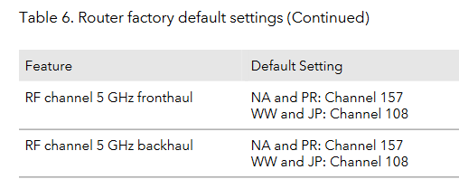

snoopyy wrote:
I seem to not be able to change my 5Ghz channel for some reason it's greyed and and appears locked or something
The RBR350 product is a "dual band" product (obviously designed to cost less to manufacture and this able to sell at a lower price point). The single 5G WiFi radio is used both for communication between User devices and the system and also for communication between router and satellites. It cannot be changed.
From page 128 of the user manual:
https://www.downloads.netgear.com/files/GDC/RBK352/RBK352_RBK353_UM_EN.pdf
In WiFi, it is up to the user device to decide which WiFi access point to use, both which to connect with first and which to change to. This seems pretty clear that the iPhone has decided there is no benefit from switching from the bedroom satellite to the router.
