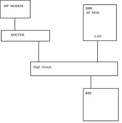

This is the setup I was trying to use - which resulted in the two Orbi units being individually reachable, but not seeing each other:

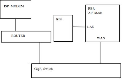

This, below, is the only setup so far where the two devices successfully see one another:
I've tested out the cables, so am confident there is no problem there. But perhaps backhaul only works when using the LAN port on the RBR....?
I'm going to try NOT using the WAN port on the RBR at all, and see what effect that has
