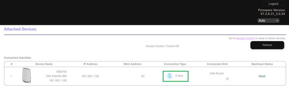

Left RBS ethernet connected to switch and switch connected to RBR after applying AP mode configuration:

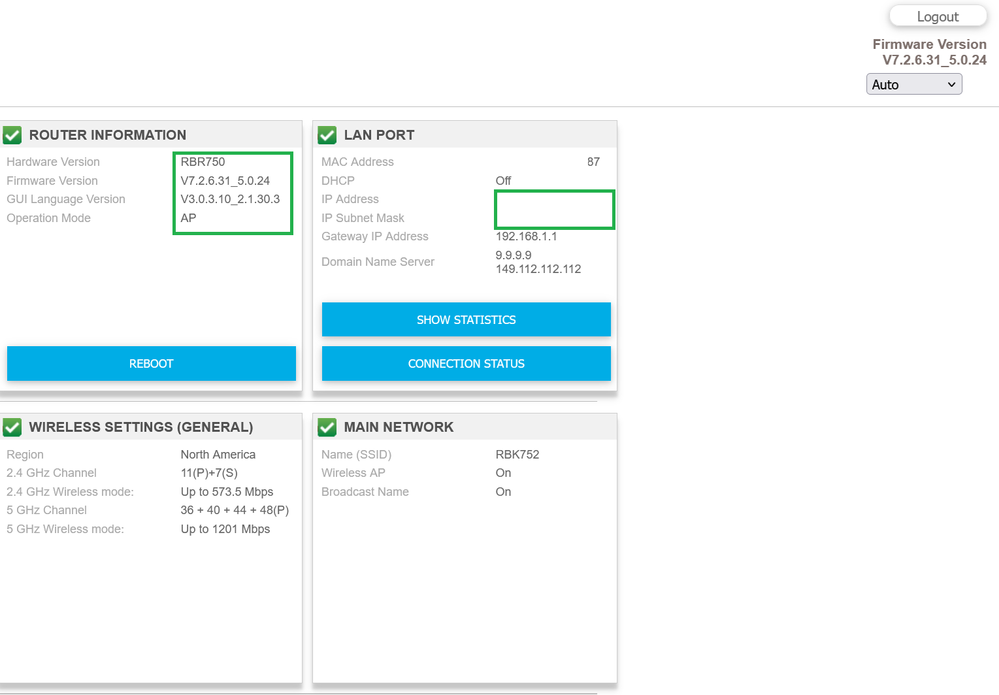

Gave several minutes for everything to settle in. 192.168.1.75 IP static IP address used on RBR for AP mode:

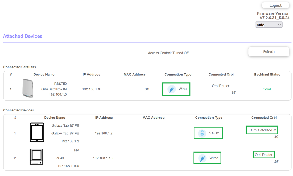

RBR AP mode connected devices page:

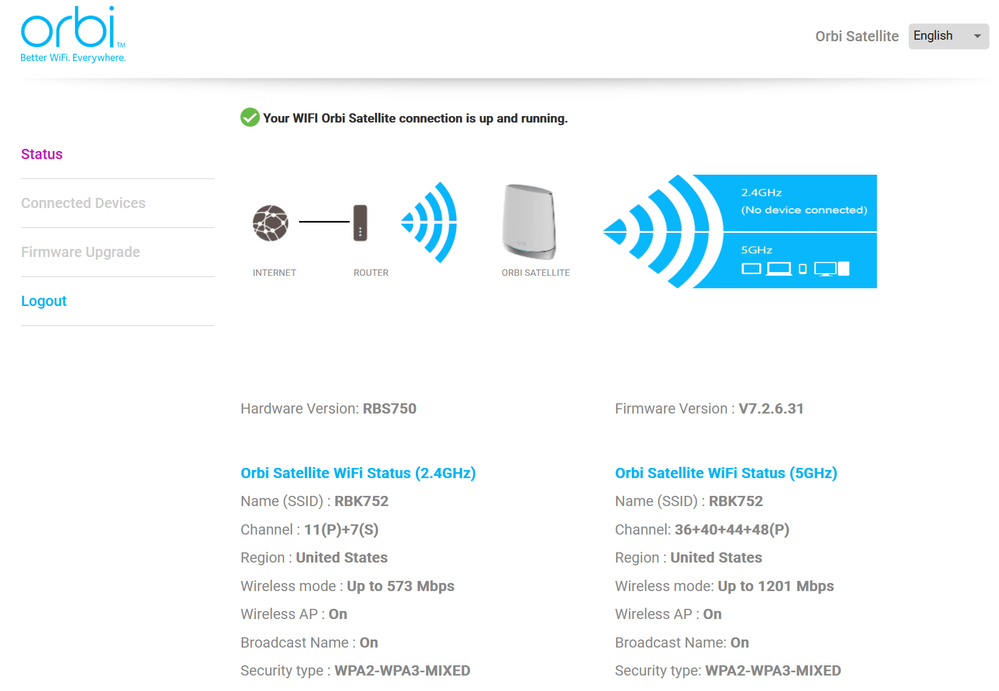

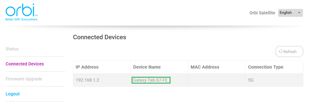

RBS web page:RBS connected devices page:

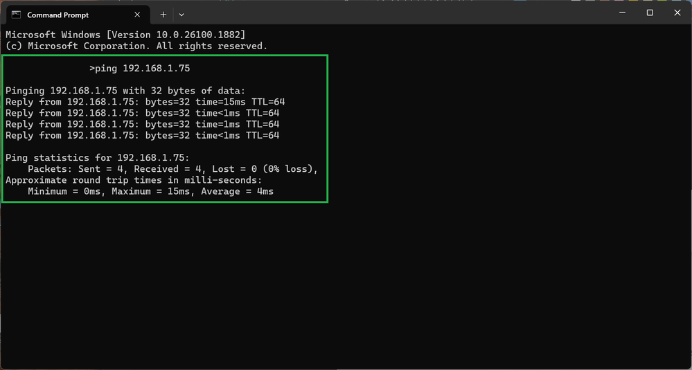

Ping results with ethernet connected PC behind the RBR:

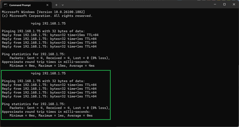

Ping results with same ethernet connected PC behind the HP LAN switch connected behind the RBR:
