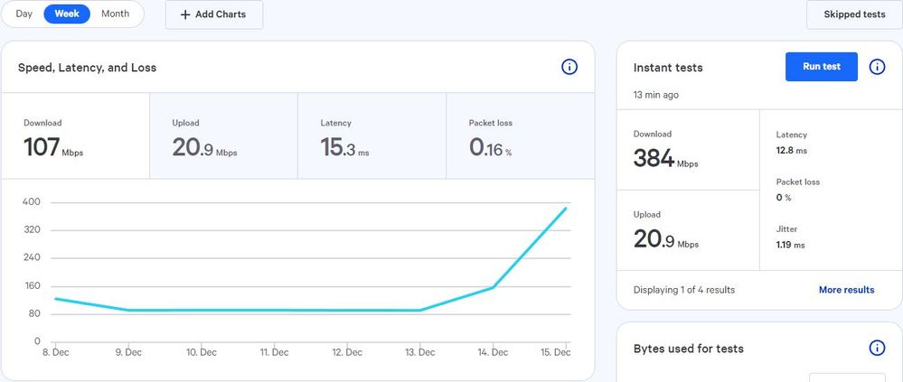

RBR750 Ethernet ports limited to 100Mbps?
All three Gigabit Ethernet LAN ports on my Orbi router seem to be limited to 100Mbps, despite apparently auto-negotiating a 1Gbps connection to the other device. The uplink to my ISP's router appear...

I logged into the WhiteBox dashboard to run another instant speed test, and was surprised to notice that the result of the scheduled test appeared to have recently increased. I ran an instant test, and the results are back to normal!I can only assume that it took a while for the Orbi factory reset to rectify the issue.
