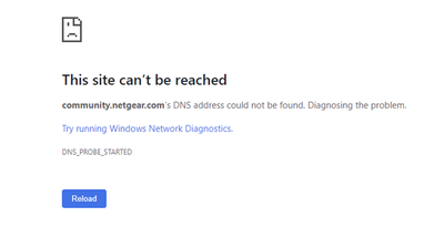

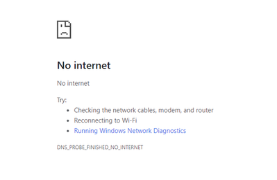

Do web pages not load? they do not load, first I get the dns error, then no internet error

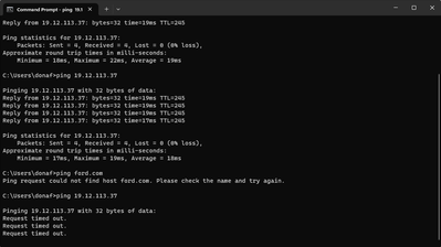

Do web pages not load? they do not load, first I get the dns error, then no internet errorWith every device except the two laptops not having a problem, there may be value in examining the laptops themselves in more detail. For example:
- Which web browser is affected? (more than one?)
- Does this happen constantly? Only for some particular web sites?
- Can you keep a command window open at the bottom of the screen
And the next time this happens, open the command window and type a couple of commands:
ping ford.com
ping 19.12.113.37
Do both commands succeed? fail? - Can you capture those error messages from the screen?
(On Windows 10, I use the "Snipping Tool" which Windows 11 may have done away with.) - Would you be comfortable changing the DNS servers being used?
