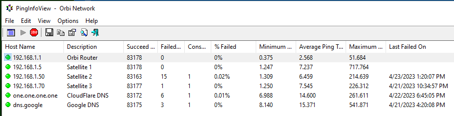

Wondering how the experiment is going?
After 48 hours, I'm "moving on":
499,068 ICMP requests from the desktop PC and only 25 either failed to reach their destination or the response failed to make it back to the PC. That satellite in the garage connected over WiFi failed more times than everything else put together

Just learning PingInfoView...I should have just taken a screenshot of the stats. That said, based on memory, I had about 900 or so failed count and ~7% failed percent...not good. I've added my internal hardware (router, and satellites) and I'll see how the stats go.
