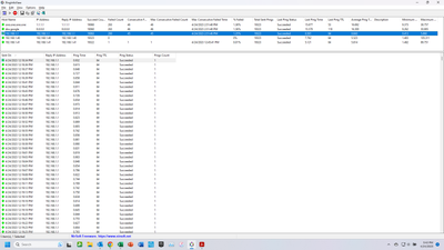

Apr 24, 2023Aspirant
It's been a light computer day today (meaning I haven't been on at all). This is important because it looks like failures increase significantly while I'm using it.
If you can't read the picture, 263 fails over a 3 hour period (1.36%), on 1.1.1.1, 8.8.8.8, and 192.168.1.1. The satellites are good.
