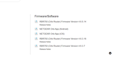

when I download the newest version, the file ends with .chk. which is not accepted by the manual update of the router, it should be .img. what to do?   and the automatic update also is not working
11 Replies
  • I have Orbi router RBR750, the latest software by the automatic update is V3.2.20.1_0.0.26, but on the support site, there is a version V4.6.5.14, when downloaded, it is a chk file not an img file so the manual update can't upload it. any idea?????

  • when I download the newest version 4.6.5.14, the file ends with .chk. which is not accepted by the manual update of the router, it should be .img. what to do?   and the automatic update also after many trails updated to ver. 3.2.20.1
    • FURRYe38's avatar
      Is this system retail or some thing given by an ISP?
      I don't see v3.2.0.20 listed on NG site...
      What browser are you using?
      What happens if you try to install v4.6.3.7.chk from the unpacked .zip file.
      All Orbi systems use .chk files.
      Be sure to update any RBS first, then the RBR lastly.
