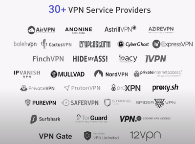

I am confused. The brume 2 supports both OpenVPN and Wireguard VPN in both Client and Host mode. The Client mode (for both VPN protocols) bundles every device on the LAN side into a VPN tunnel directed to one of these VPN providers:
The brume 2 supports VPN Host mode for both OpenVPN and Wireguard. Wireguard Host listens on port 51820 while OpenVPN Host listens on port 1194. Since the brume 2 is connected directly to the Internet Service Provider (ISP), there is no reason to implement port forwarding on the Orbi router, which is connected on the LAN side of the brume 2.
