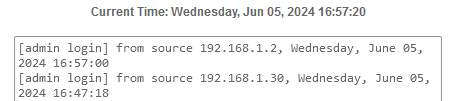

Installed Wireguard Client on Windows 11. Used same user configuration as on phone (even though Wireguard wants each device to have a separate configuration file. What's that about? I could see different users having unique config files, but each device?). Also worked, "no problem." The laptop log file is much more detailed than the Android app log.
One significant difference I see between using the VPN host that is part of the router firmware is that connecting via VPN creates an entry in Attached Devices with a unique IP address numbering scheme. This also appears in the Orbi log.
When connecting to Wireguard that is running on a device on the LAN, there is no record of the VPN connection and the traffic appears to be coming from the Wireguard Host device.
This screen shot of the Orbi log shows where I opened the Orbi web admin interface at 16.47 with the laptop connected via Wireguard VPN. (Through the Raspberry Pi with IP address 192.168.1.30). Then at 16:57 I opened the web admin from a desktop computer on the Orbi LAN at 192.168.1.2
As far as the Orbi knows, both of these connections were from the Orbi LAN. Neither is identified as being "remote".
