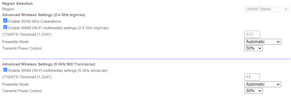

1. I have not disabled AX mode on 2.4 or 5ghz. I thought we should leave it on for faster connections?
2. CTS is 500 for the 2.4ghz (so that some older devices can connect). 64 for 5ghz. I thought lower is better?
3. Distances between RBR and RBS is more than 30 feet on the first floor and 30 feet on the second floor.
4. I've tried changing the 2.4ghz and 5ghz to 25% and still have the same issue. I cannot individually change the RBR and RBS wireless power.
5. 2 RBS, both wireless backhaul.
- FURRYe38Aug 05, 2022Guru - Experienced User
hiltxan wrote:
1. I have not disabled AX mode on 2.4 or 5ghz. I thought we should leave it on for faster connections? Short term testing, disable AX mode for now.
2. CTS is 500 for the 2.4ghz (so that some older devices can connect). 64 for 5ghz. I thought lower is better? Both should be same value. Set both for 64. CTS values are to help with wifi collisions between RBR, RBS and devices only.
4. I've tried changing the 2.4ghz and 5ghz to 25% and still have the same issue. I cannot individually change the RBR and RBS wireless power. Turn up the power to 50 % after turning OFF one RBS.
5. 2 RBS, both wireless backhaul. Lets turn OFF one RBS for now.
