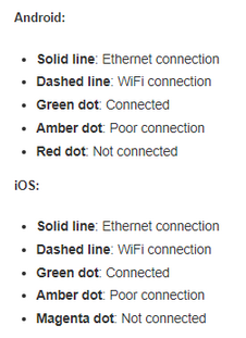

- CrimpOnMay 01, 2022Guru - Experienced User
OrlandParker wrote:
I went to check the firmware and now the router seems to be offline. In the network map in the app, the dot is grey instead of green.
This is really annoying because grey is not one of the possible colors:
(Grey obviously IS a possible color, because a number of users have reported seeing grey. But, I have no idea what the heck it indicates.)
