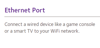

        One solution is to install some product next to the Lorex console that will:
        • Provide an Ethernet jack to connect to the Lorex console, and
        • Connect to the Orbi system over WiFi.
        Many models of "WiFi Extender" can do this. For example, the Netgear EX3700 https://www.downloads.netgear.com/files/GDC/datasheet/en/EX3700.pdf
        The EX3700 is available on Amazon for under $30US.
