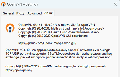

Which version of OpenVPN is installed on the Windows laptop?

This is the version of OpenVPN running on the remote computer:

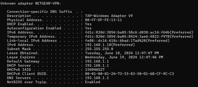

Here are the images from the remote laptop:
On the interface for the router from within the LAN (not via VPN), the laptop connected via VPN does not appear. There is no VPN section listed like there is on the image you provided. None of the devices have the 1.18 IP address assigned either.

This appears to be evidence that the VPN connection has succeeded.
- The default IP subnet for Orbi routers is 192.168.1.x, and a device connected with the Windows Open VPN TAP protocol will receive an IP address on the Orbi LAN. (192.168.1.18 is such an IP address.
When I connect to my test RBR750, the LAN IP is 10.0.0.x and this is why my VPN connection receives the IP assignment that it does.
What is not expected is that the Orbi router Attached Devices does not identify this device.
Would it be possible to attempt a VPN connection with another device? perhaps a smartphone or tablet?
