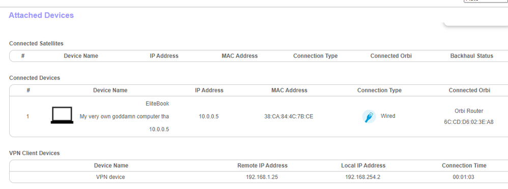

My situation remains the same (RBR750, v7.2.6.31). I downloaded the smartphone ovpn file and installed it on a Samsung tablet (Android) using OpenVPN Connect v3.2.0 (8367). Opened a VPN connection to the Orbi with this result:

Using the tablet, I opened a browser connection to 192.168.2.1 (the 750 router) which shows the same information as the screen shot above.
