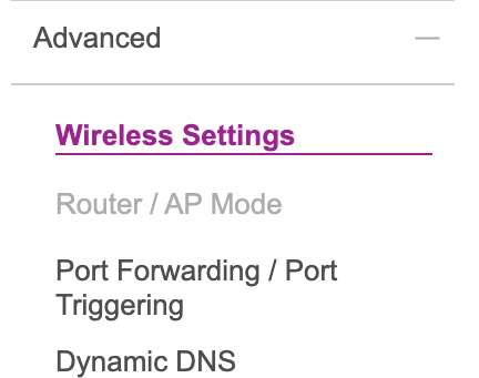

RBR750/RBS750 AP mode grayed out
Hi all, I need to put real firewall in front of my Orbi RBR750 (V4.6.9.11_2.3.5), but AP MODE/Router is grayed out Am I doing something wrong? Also do I need RBSes to be physically plu...

- FURRYe38Oct 13, 2022Guru - Experienced User
The mode seen on the UI should never be grayed out from my experiences. Unless you have some controlling configuration on the RBR currently that may prevent this, the feature on the RBR should be enabled. If you can't get the feature to enable, then try a reset on the RBR and setup from scratch, then go in and configure AP mode.
