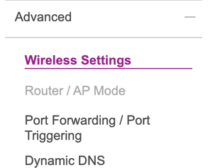

RBR750/RBS750 AP mode grayed out
Hi all, I need to put real firewall in front of my Orbi RBR750 (V4.6.9.11_2.3.5), but AP MODE/Router is grayed out Am I doing something wrong? Also do I need RBSes to be physically plu...

Mystery of "grayed out" is solved:
If WAN aggregation is set to enabled (WAN port and 1st LAN port are LACP bound) you can not switch to AP mode.
