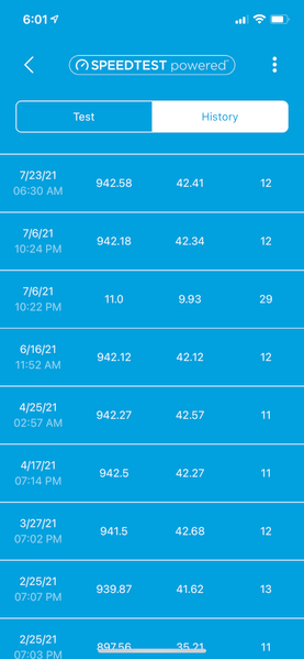

RBR750/RBS750 download speed dropped 300Mbps after fw 4.6.3.7
My Ookla speedtests went from 940/41 download/upload speeds to 600/41 download/upload speeds after the firmware upgrade. There was no change to my isp or router. I've tried restarting, but that did n...

FURRYe38 thank you again. I was able to test wired connection with a chromebook. Wired to the modem I saw 900Mbps down and wired to the router I saw 870Mbps down, so no issue with speed, only the speed test on the router
