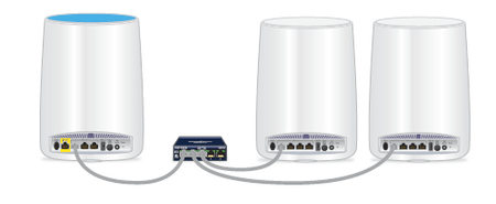

The Yellow WAN port does and is required to be connected to the UP stream host routers LAN port in AP Mode.
If the RBS are ethernet connected and a LAN switch is used and needed, then this switch needs to be connected behind the RBR on any of the LAN ports in back of the RBR. Then each and any RBS that needs to be ethernet connected, can connect to this switch:
Internet <-> Router (+DHCP +DNS) <-> | - RBR850 (WAN Port Connected to host routers LAN port)
LAN SWITCH connected to RBR850 LAN Port>
| - RBR850 (LAN Port to LAN Switch)
| - RBS850 (LAN Port Connected to LAN switch)
| - Wired Device
| - Wired Device
| - Wired Device
| - Wired Device

I know there's no way to get 10G speeds out of the RBR850 - it's only got 2.5G on the WAN port and 1G on the LAN ports.
I was hoping it was flexible enough to handle both both the backhaul and incoming network on the same port, but that's not the case.
So, for anybody else reading in the future: I'll have to run another cable, so that the RBR850 will have:
- One 2.5G connection from the RBR 850's WAN port (done) to my network closet / 2.5G switch for normal network traffic.
- One Gigabit (or better cable) from the RBR850's LAN port to my network closet for the gigabit ethernet backhaul.
And the RBS850 will (still) have:
- One Gigabit (or better) cable from the RBS850 (Satellite) to my network closet for the gigabit ethernet backhaul.
And I'll need to connect the two ethernet backhaul cables using either a switch, or maybe even a crossover patch cable.
