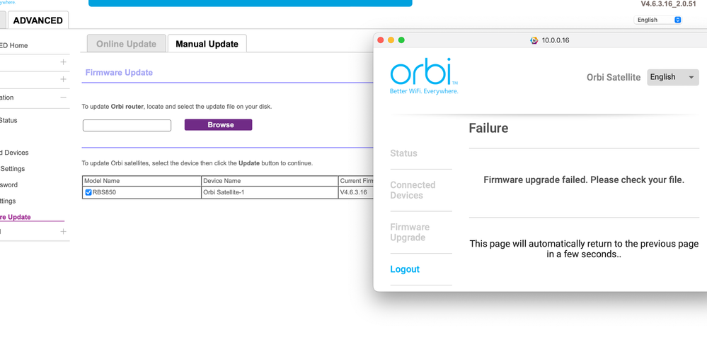

Onto the good advice you give about firmware updating. In fact, I did exactly that already 🙂 . I connected directly to the Orbi router with ethernet and had a browser interact directly with the RBR850 router. I tried to manually update the firmware of the satellite, after I separately connected through a smaller window to the satellite RBS850. Then I tried to manually install the firmware. No go. Did not work. I will try again. you mentioned that you connected your ethernet line to the satellite not the router- would that make a difference?

Just to follow-up.
- I connected directly (ethernet) to the RBS850 satellite.
- Opened browser interface to the RBR850
- Went into Manual Update of Firmware, of just the satellite first as manual instructs, using the latest firmware Netgear offers for the RBR850
But the procedure failed again.
You can see the message below.
Question: is it risky to update manually the Router first and not the satellite?

Update:
Firmware update worked (manually)
I'm such a dummy.
I didn't realize that there were TWO firmwares, one for the router and one for the satellite.
They are not the same file, and my error message above was because I was trying to install the router firmware update onto the satellite.
Anyways, I downloaded two firmwares, one for router, one for satellite.
I installed the satellite first
Then the router, as recommended.
Both installed, as you can see below.
And now I will wait and see if this fixed the problem of lost internet connectivity. Will let you know.
But please Netgear, we really should not have to go through this to update our firmware and have a stable internet connection. I should be able to do this from the Orbi app.
Thanks for the help of both the experts who contributed above. Really appreciate the goodwill people show in helping others. 🙂
