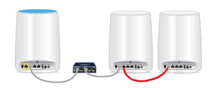

Hi all, Just installed a new 850 kit w/1 * RBR850 and 2 * RBS 850's. RBR are connected to the Cisco Gb switch RBS #1 are connected to the Cisco Gb switch RBS #2 are with wireless only place...

Are you saying that we CAN expect issues where RBS #2 only connects wirelessly to RBS #1?
Our testing last night was working, suddenly stopped for a while, then re-connected.
/Stigh

Already we have had issues.
Disconnected the RBS #2 now and will try to use only RBS #1 from the floor above.
If that become stable, my 'kind-of' conclusion will be that we should use a cable from RBS #1 -> RBS #2.
I'll keep you updated!
