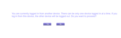

I could not get the modem to connect so I reset the static IP address on my workstation and rebooted. I could not initially get to 192.168.100.1 but it would not let me log in. I had to RESET the modem. Once I did I was able to get to sites like Facebook or CNN but not much else. It took about 10 tries to get to this post. The modem's admin console keeps resetting itself and asking me to log in again. After about 5 or 6 logins I got this:
Now about 5 minutes in it seems like I can get to Home Depot, Macy's, and the other problematic sites just fine.
