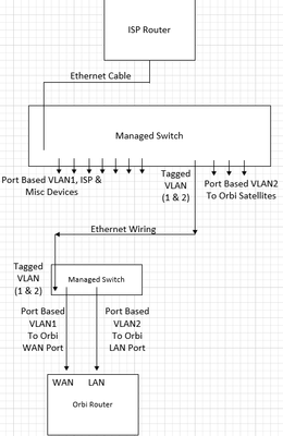

There was a discussion on the forum about how to use one Ethernet cable to carry:
- The ISP connection from the patch panel to the router WAN port, and
- The router connection from LAN ports to satellites
The concept is illustrated with this diagram:
The managed switch at the patch panel has two port based VLANs:
- VLAN1 connects the ISP router and any miscellaneous devices around the house.
- VLAN2 connects the Orbi satellites to the swith
There is one "Tagged" VLAN port, which carries VLAN1 and VLAN2.
At the WiFi router location, there is a second managed switch with two port based VLANs:
- VLAN1 carries traffic to the router WAN port
- VLAN2 carries LAN traffic destined for Orbi satellites
There is one "Tagged" VLAN port, which carries VLAN1 and VLAN2 traffic. In addition, if the user desires, miscellaneous devices can be connected to this second switch as Port Based VLAN (1 or 2. Doesn't really matter.)
The "magic" comes from VLAN tagging. Once the Ethernet switches have used ARP to discover where everything is, they know which port to use to reach every device. None of the devices themselves are aware of the VLANs. If a packet comes into the switch on a VLAN1 port, it can only go to other VLAN1 ports. (Same for VLAN2) So, packets from the ISP router will never go directly to Orbi satellites, because they are on VLAN2.

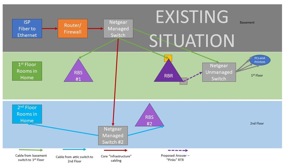

- vader716Jan 06, 2024Aspirant
I think this is close to my solution minus the VLAN tagging which I can implement. Apologies for the rudimentary diagram but here is the current network topology.
I do not understand why I should/would put an ORBI in front of either the first managed switch in the basement or worse yet the first device after the ISP.
With ARP and IP addressing I'm unclear why RBS 1 and 2 can't reliably find RBR.
As of now all three APs are working and passing wireless traffic but RBR can't "see" the RBSs in the App or Web GUI.I can VLAN them but it too seems odd to me.
You'll notice the purple dotted line was one answer given. When that happens the RTR goes pink and all traffic is lost on that AP. Feel like that is creating a network loop and bringing a halt to traffic. - schumakuJan 06, 2024Guru - Experienced User
I guess I could relocate the RBR to the basement (hurting wireless coverage) but if it is in AP mode and just relaying traffic what is the technical reason it has to be in front of an actual managed switch. Unless there is just some limitation in the Orbi to find other devices on the network.
- FURRYe38Jan 06, 2024Guru - Experienced User
Manages switch are known to cause problems for Orbi systems and the connecting RBS. Router or AP modes. Especially for ethernet connected RBS. Some users have been able to make them work with managed switches by disabling all IGMP Protocols and Green Ethernet features on thise switches. However when those don't work, un-managed switches are recommended in between the RBR and RBS for best connection and operation for ethernet connected RBS.
This is the commended configuration for ethernet connected RBS if you have a LAN swtich in the mix:
NG GS-105/108v4 and GS308v3, D-Link DGS-105/108 and HP ProCurve 1400 series non managed switches work for Orbi systems.
