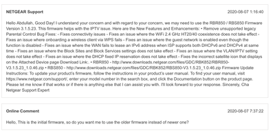

NG support asked me to use the intial RBR850 support.
Hello, Good Day! I understand your concern and with regard to your
concern, we may need to use the RBR850 / RBS850 Firmware
Version 3.1.5.23.
This firmware helps with the IPTV issue. Here are the New Features and Enhancements: • Remove unsupported legacy Parental Control Bug Fixes:
- Fixes connectivity issues - Fixes an issue where the WiFi
2.4 GHz HT20/40 coexistence does not take effect
- Fixes an issue where onboarding a wireless client via WPS fails
- Fixes an issue where the guest network is enabled even though the function is disabled - Fixes an issue where the WAN fails to lease an IPv6 address when ISP supports both DHCPv6 and DHCPv4 at same time - Fixes an issue where the Block Sites and Block Services settings does not take effect - Fixes an issue where the VLAN/IPTV setting does not take effect - Fixes an issue where the DHCP fixed IP reservation does not take effect - Fixes the incorrect satellite icon that displays on the Attached Device page Download Link:. • RBR850 - http://www.downloads.netgear.com/files/GDC/RBK852/RBR850-V3.1.5.23_1.0.46.zip • RBS850 - http://www.downloads.netgear.com/files/GDC/RBK852/RBS850-V3.1.5.23_1.0.46.zip Firmware Update Instructions: To update your product’s firmware, follow the instructions in your product’s user manual. To find your user manual, visit https://www.netgear.com/support/, enter your model number in the search box, and click the Documentation button on the product page. Please let me know if that works or if there is anything else that I can assist you with. I'll look forward to your response. Sincerely, Cha Netgear Support Expert
This doesn't make sense to me.
Do you think RBR850 Intial firmare had IGMP v2 support?
