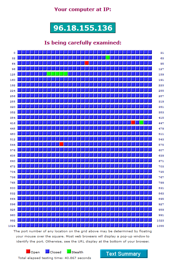

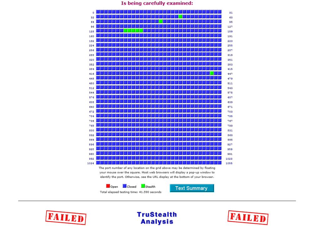

- FURRYe38May 17, 2020Guru - Experienced User
Ok, I tested mine. RBR850 in router mode behind a host router in the host routers DMZ to be sure the host router isn't interferring.
uPnP test passes:
I also see ports open and stealthed:
GRC Port Authority Report created on UTC: 2020-05-17 at 18:56:05
Results from scan of ports: 0-1055
3 Ports Open
1046 Ports Closed
7 Ports Stealth
1056 Ports TestedPorts found to be OPEN were: 80, 443, 554
Ports found to be STEALTH were: 53, 135, 136, 137, 138, 139, 445
Other than what is listed above, all ports are CLOSED.
TruStealth: FAILED - NOT all tested ports were STEALTH,
- NO unsolicited packets were received,
- NO Ping reply (ICMP Echo) was received.----------------------------------------------------------------------
I see an earlier test from January is a bit different:
I'm going to have to restest this, I think the test reports on what is first NAT processor, so either the gateway modem if there is a router built in there or at the 1st NAT router after a modem with out a built in router. I'm getting same results with the host router that my RBR850 is connected too so this test is not valid:
I'll try and find some time to retest this again when I can kick everyone off line for a few minutes to test the RBR directly with my modem.
So be sure when your testing the RBR, be sure it's connected to a modem only source with no NAT and be sure ALL devices are disconnected from the RBR including RBS. Change the SSID name temporarily to something else that your devices won't connect too. Once testing is done, change the SSID name back. Also be sure to close any and ALL back ground running apps on your test PC aswell as these apps can have open ports giving false positives in the test.
